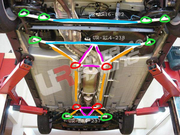

                MW, I think the catch is that, while the braces attach to the suspension, they ALSO attach to the chassis. This means they must conform to the rules of both sections I've quoted.
                See the attached photo. I've noted suspension pickup points in green and chassis points in red (with a little guesswork on that rear triangulated bar). The bars outlined in blue would be legal suspension braces. The bars in orange would be legal chassis braces (with an extra note tossed in for the center channel). The bars in purple are not legal outside of Prepared classes. At least, this is my interpretation of the rules, which may be off.

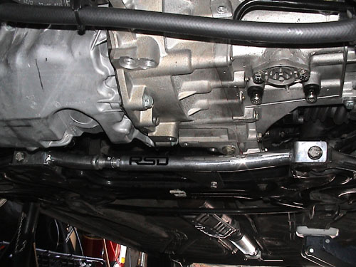

                That bar in the front does pick up from the control arm mount, but is triangulated with other chassis points, making it a chassis brace and not just a suspension brace. A legal suspension brace would look like this (from a 1.8t VW) ...
                It only connects the inner mounts for the control arms, nothing else.
                Nothing says the Cube can't run national events, especially in a Prepared class. If it is lowered or has a wide enough track to meet the W:H requirements for SCCA autocross, it has a class. For an ST build, it would be STC ... the "catch-all ST class.
                But if Ervin is your only competition currently, sounds like he wants you to run STF. If any other competitors and the event chair don't care, I'd say run STF all day, regardless of the barces and classifications. That's what Katie did last year to have some competition.

                  Thank you TB. That clears it up for me. I know that there is a different type of front brace that would be legal. I may look to swap it out and see what I can do to make the rear legal too. As for now, like you said, if STF is ok, I'll run in that class else, I'll bump. Thanks again. Ps. nice graphic!
