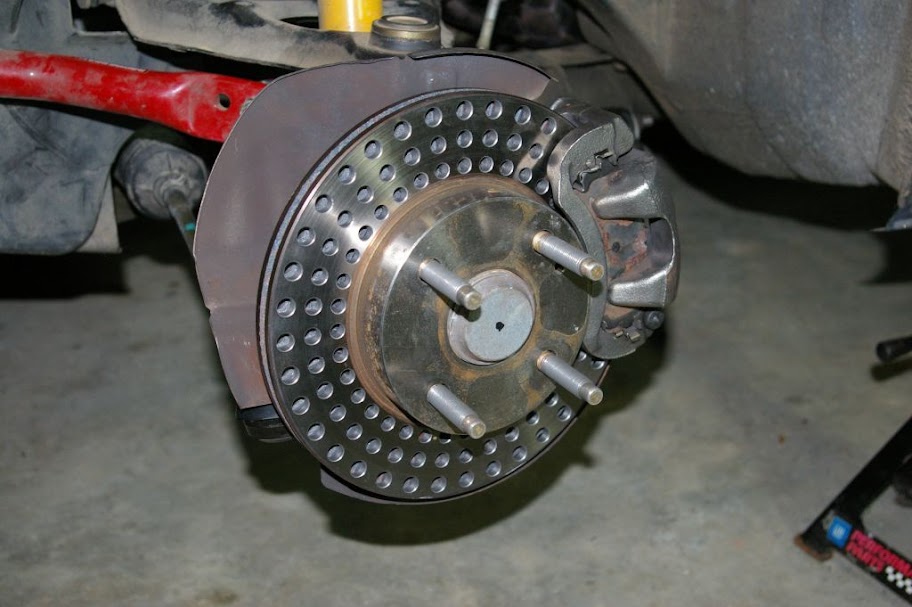

    It's amazing how much weight you can take off of a Miata if your not overly concerned with brakes.
    324 holes.
    I would just not run rear brakes if I was going to swiss cheese them. And take off the body panels.
      Neither of which are legal mods in SP.
        So how long did it take to drill all them holes?
          Almost four hours. We used a mill and rotatory table, CNC if we do it again.
            They look good.
            Can you also remove material around the studs?
            What about not having the perimeter round? Something like this:
            The fronts are vented. The rears are not. Can you use a rear rotor on the front? Or maybe remove one of the surfaces and then machine the backside of the remaining one?
              All good ideas, the rears are much lighter but I don't know if they could take the heat. I really want to see how the hold up before I do anything else, I'm going to get a whole set as spares just in case.
                Looks like a set I saw on a Neon I ran against a few years ago. His ended up cracking on the rear.

                        so how much weight did you actually drop doing this?
                        Andrew Maffessanti
                        Atlanta Region SCCA
                        114 DP
                        www.DIYAutoTune.com
                          1.6 pounds each on the front and 1 pound each on the rear.
                            Not a ton, but not bad for a semi-free mod

                              These things failed yet? =)
