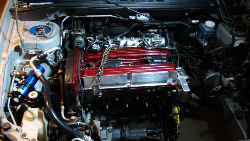

Here's engine bay with almost everything removed, turbo, radiator, tranny, transfer case etc etc.

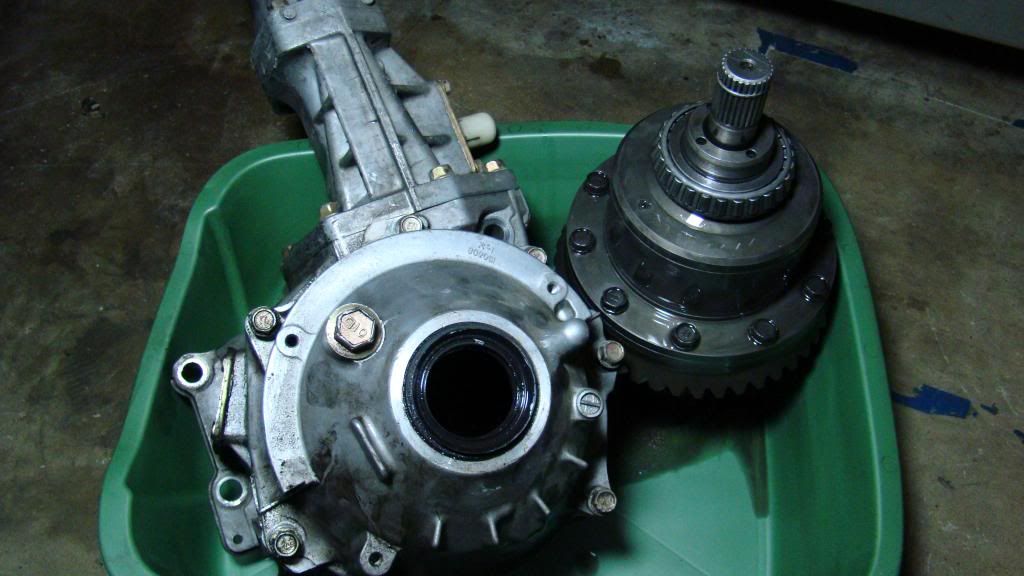

differential removed from transfer case housing.

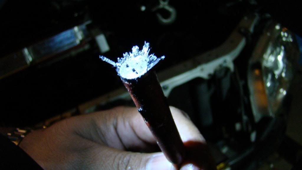

Metal shavings from a magnetic stick

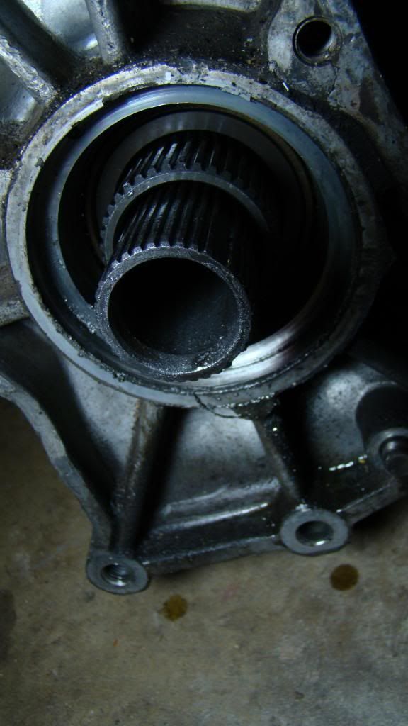

This is where the transfer case is sync on to the tranny. notice the metal shavings on it??

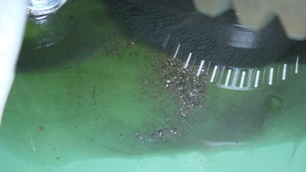

This came out with the T case fluid
