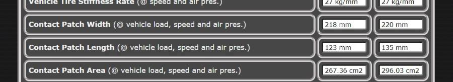

    I would recommend going with 18's as you have more tire options on the 18" wheels. In regards to tire diameter, the shorter tire will give more torque, but the tires will struggle to put power down as well as you will have a reduced contact patch. It will be a compromise.

      Also, you mentioned less contact patch with the 17's, but if the widths are the same, the contact patch should be as well, right?

        Nevermind. I see your point on the contact patch difference.

          Yeah, that's why it's common to see Porsches on 20" wheels from the factory now. Everyone wants the longer contact patch for the longitudinal grip.
