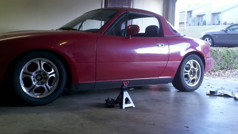

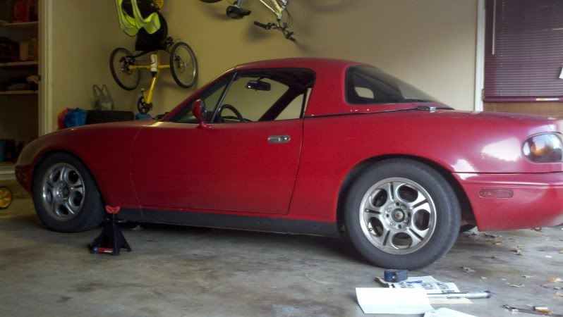

    Here the car is as it sits right now.
