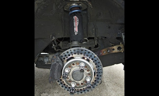

                    Years ago there was a FSP VW that swiss cheesed the brake rotors. Now there is a rule in place that limits that sorta thing.
                    • #40
                      Not in SP there is not.
                      Schenker’s on off Swiss cheese brakes.

                        There's no VW in SP or there's no rule limiting? I haven't read the rules lately but I thought that there was some wording added to the brake rules limiting the amount of voids that can be added.

                          I know nothing of the VWs but the rules on brakes changed a couple of years ago. Below are the sections that make the brakes in the picture legal.
                          15.6 BRAKES
                          D. Alternate brake rotors are permitted, subject to the following restrictions:
                          1. Rotors must be ferrous metal except for standard parts. Aluminum
                          rotor hats are allowed. Rotor dimensions (diameter and thickness)
                          must be equal to or greater than standard parts. Cars originally
                          equipped with solid (non-vented) rotors may utilize vented rotors.
                          2. Cross-drilled and/or slotted brake rotors may be used. Slots/holes
                          are permitted only in the braking area of the rotor. Rotors featuring
                          a drum-type parking brake in the hat area of the rotor may not be
                          drilled or slotted in the parking brake area.
                          H. Brake calipers may be replaced, provided the number of pistons
                          is equal to or greater than the original number of pistons. Caliper
                          mounting brackets may be replaced to accommodate this change,
                          but may serve no other purpose. Alternate caliper brackets must bolt
                          to the original caliper bracket mounting location(s).

                            Okay maybe they just talked about limiting the number of slot/holes/voids. For my RX-7 where the hubs are integral to the brake rotor, cracked rotors are a serious pain and can get expensive. Most cars these days the rotors are separate from the hubs and much easier to change.

                              the ones posted in the picture are considered "motorcycle" brakes..

                                You're thinking of ST, where there is a limit to the amount of void on a rotor. There's nothing in SP.
