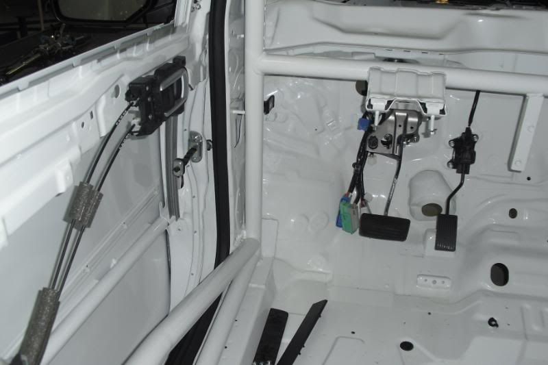

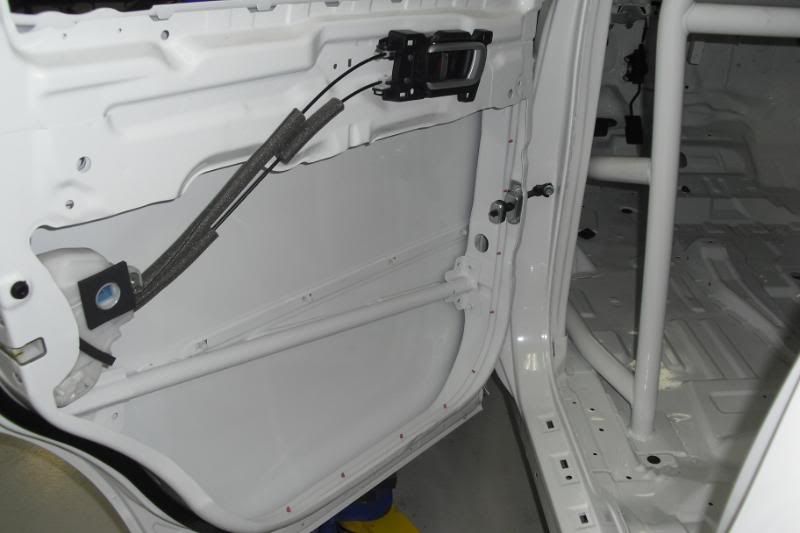

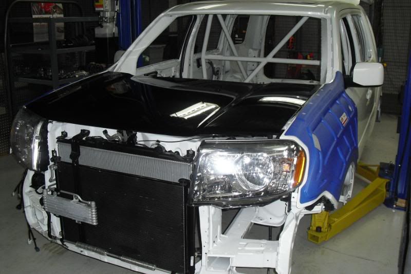

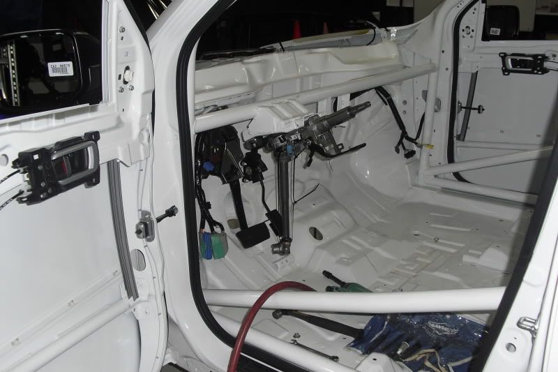

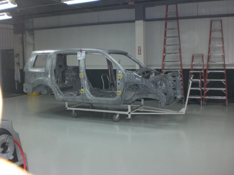

We started with a new body(VIN#13)
and took it to Mark at Kirk racing for a cage. There are still a few bars we need to add after looking closer at the rules.
